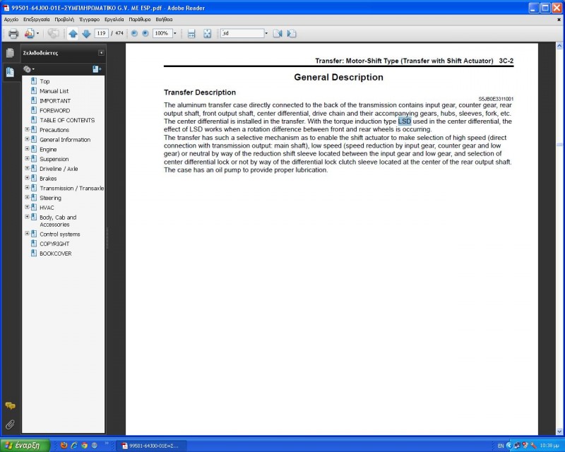

Δημοσίευσηαπό kaliakouda » Πέμ Μάιος 24, 2012 11:17 pm
Από το βιβλίο του κατασκευαστή :arrow:
ΠΡΟΣΟΧΗ ΣΤΗΝ ΔΥΝΑΜΟΜΕΤΡΗΣΗ!!!!!
Transfer Warning
S5JB0A3310002
! WARNING
This transfer has a center differential.
When testing with 2-wheel chassis
dynamometer or speedometer tester (which
tester roller is driven by vehicle wheels), be
sure to make the vehicle as rear wheel drive
or as front wheel drive temporarily as
follows.
Otherwise, front wheels drive rear wheels or
vise-versa and personal injury may result
1) Remove front propeller shaft or rear propeller shaft
referring to “Propeller Shaft Removal and Installation
in Section 3D”.
2) Install special tool (cap) to flange yoke cover hole
(front or rear) of transfer (1) and fix it to transfer or
hook with string to prevent oil leakage from transfer
Transfer Description
S5JB0A3311010
The aluminum transfer case directly connected to the back of the transmission contains input gear, counter gear, rear
output shaft, front output shaft, center differential, drive chain and their accompanying gears, hubs, sleeves, fork, etc.
The center differential is installed in the transfer. With the torque induction type LSD used in the center differential, the
effect of LSD works when a rotation difference between front and rear wheels is occurring.

Δημοσίευσηαπό apollo » Παρ Μάιος 25, 2012 11:14 pm
kaliakouda έγραψε: the
Μάλιστα :think: :think: Υπάρχει κάποιος που να μπορεί να μας πεί (επίσημα) πόση πρέπει να είναι αυτή η διαφορά μεταξύ μπροστά και πίσω τροχών ώστε να δουλέψει το LSD;;;; :whistle: :whistle:
