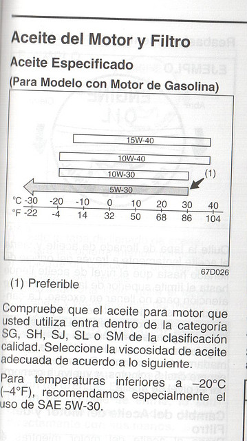

It is highly recommended to use SAE 5W-30 oil.However, SAE 10W-30 oil is usable for ambienttemperatures above –18 °C (0 °F).
-Engine oil specifications (J20 Engine)Oil pan capacity: About 5.0 liters (10.5 US pt. / 8.8lmp pt.)
-Oil filter capacity: About 0.2 liters (0.4 US pt. / 0.3lmp pt.)Others: About 0.3 liters (0.6 US pt. / 0.5 lmp pt.)
-Total: About 5.5 liters (11.6 US pt. / 9.6 lmp pt.)
