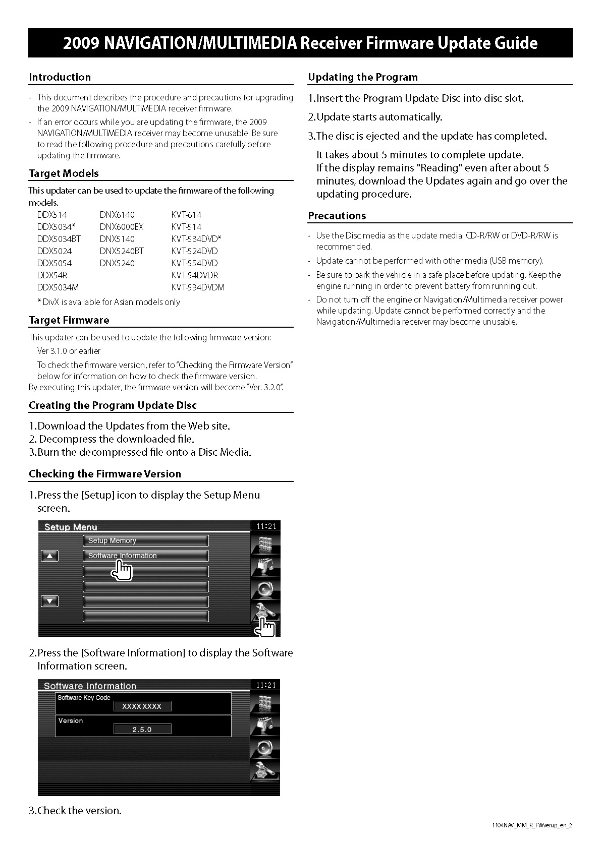

Λοιπόν, εδώ:
Πριν προχωρήσεις, να βρεις ποιες εκδόσεις λογισμικών έχεις ώστε αν είσαι ok να μην μπεις στο κόπο να τα κάνεις ;-)
- το 1ο link: λέει:
Update your Kenwood receiver software before updating your Garmin navigation software. To learn more, visit από όπου κατεβάζεις τους drivers:
και ακολουθείς τις οδηγίες που σου λέει εδώ:
....και σε jpg ;-)
- το 2ο link: λέει:
After updating your Kenwood receiver software, you're ready to download the latest navigation software for your device.
Πατάς στο link και σε βγάζει εδώ: , πατάς Agree και μετά το κατεβάζεις: και έχει και οδηγίες:
Installation Instructions
1. Download the appropriate self-extracting archive file onto your PC.
2. Run the downloaded executable file.
3. Click on Browse and a select temporary location of your choosing to extract the update.
4. Click Unzip to extract the update.
5. Wait for the message that the update was unzipped successfully and close the updater.
6. Insert a burnable CD into your PC.
7. Use CD burning software to create a 'garmin' directory on the CD.
8. Add the files extracted in step #4 to the 'garmin' directory on the CD.
9. Burn the files to the CD and eject the CD from the computer.
10. Turn on the Kenwood Navigation System and press the [NAV] button to switch the display to the navigation system screen.
11. Insert CD into Kenwood Navigation System. If there is already a CD in the drive, temporarily remove it first.
12. Your Kenwood Navigation System will ask if you would like to update software. Answer 'Yes'.
13. The unit will display banner 'Navigation Map Update Start'.
14. The unit will restart several times during the update. The CD will eject before the update is complete. The warning page will display when the update is complete.
15. Do not power off unit while the update is in progress. When finished you can verify the update by checking the version number in Menu->Settings->About->Software.

το πρωτο βημα την αναβαθμιση λογισμικου την εκανα με απολυτη επιτυχια . περασα στο δευτερο βημα για τους χαρτες ακολουθωντας τις οδηγιεσ του φιλου panos αλλα κολησα σε ενα σημειο. μου κατεβηκαν 2 αρχεια ενα με το ονομα GUPDATE.GCD και ενα αλλο με το ονομα κ08v5_update_78dfd438_3.2.0ruf. περναω και τα 2 στο cd? τα βαζω σε καποιο φακελο η μηπως περναω μονο το ενα?
