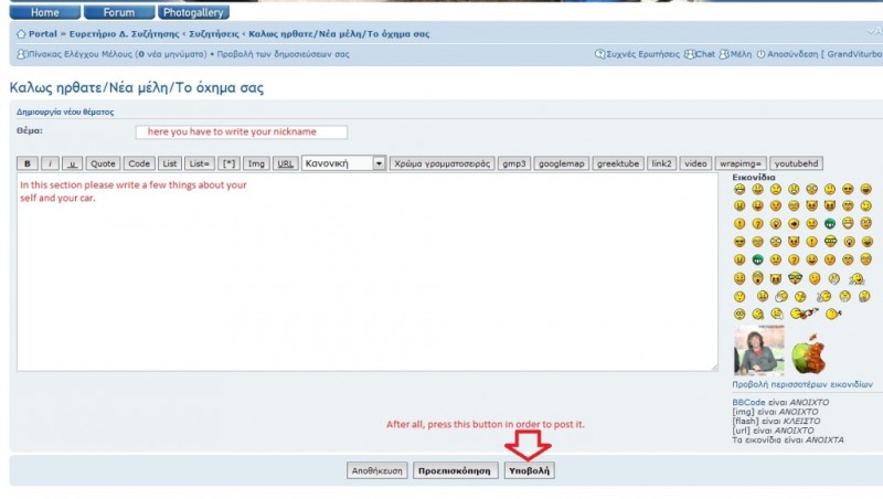

Δημοσίευσηαπό Επισκέπτης » Τετ Μαρ 10, 2010 8:03 pm
Good Evening Moex,
Even though you r not able to speak our language , i would suggest you to introduce your self ( what you've already done in this thread) in this section.
viewforum.php?f=26
in order to do this, please press the ΝΕΟ ΘΕΜΑ* which is located upper left section on your page, and after filling in the form we are gonna be able to answer all your questions. This a rule in order our forum work correctly.
See the tutorial below in order to fill the form.
Regards,
Peter.
