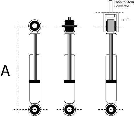

"The MX6 adjustable without reservoir shocks are ? 122,50 each excluding shipping cost.
By ordering 4 pieces the same time each shock is ? 117,00
MX6-6053 is a Medium valving shock, extended 23.5" and collapsed 15.6" beware the MX6 skock are allway's loop/loop.
On some Suzuki Vitara's (depending of the year) you need a Stem (pin) in this case you need a Loop/Stem convertor (? 47,00) witch increase the lenght with 1".
The travel of the 6053 series is 7.9", this means 4" in and 3.9" out.
So the shock for the Vitara must have a distance from eye to eye of 15.6" + 4" = 19.6" (49,8cm) when the car is just standing on his tires on a flat road without load.
If this is correct you have the correct shock.........

Οι οδηγίες που μου έστειλαν οι Ολλανδοί λένε οτι όταν το αμάξι είναι σταματημένο σε επίπεδο μέρος, τότε πρέπει από βίδα σε βίδα να έχω 50 cm για να μπορεί να δουλέψει σωστά αυτό το αμορτισέρ.
Τα procomp έχουν διαστάσεις:
23,50 X 2,54 = 59,69 cm ΕΝΤΕΛΩΣ ANOIXTA
15,63 X 2,54 = 39,70 cm ΕΝΤΕΛΩΣ ΚΛΕΙΣΤΑ
