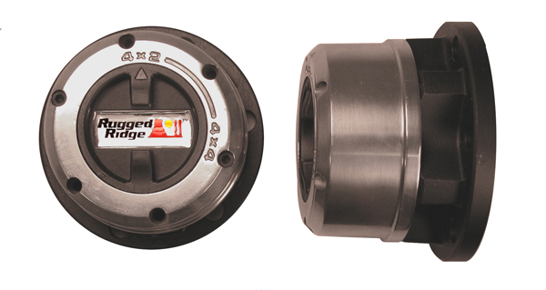

Τελικα σταθηκα ατυχος τελειωσε το αποθεμα των ΜΜ πλημνων και μου προτεινε αν θελω να μου στειλει αυτες.Ταιριαζουν στο GV μοντελο του 2004.Γνωριζει κανεις τιποτα για αυτες?
MANUAL LOCKING HUBS, RUGGED RIDGE, SUZUKI SAMURAI (SIERRA) 82-94, SIDEKICK (VITARA) 94-04; GEO TRACKER 89-98, CHEVROLET GRAND VITARA 99-04
Approved as original equipment by vehicle manufacturers and militaries world wide, these tough hubs are built to last. A hardened nylon center is used instead of metal to keep you moving in the rare case of a hub failure.
These locking hubs are for a 6 bolt, 26 spline Axle. They are constructed of Military spec hardened nylon center dial that will not damage other parts in unlikely event of a failure. Recognized unanimously as The Tough Hub by many thousand satisfied users worldwide. #15001.38
Ultra reinforced nodular iron body.
Salt-spray tested epoxi enamel finish.
Die cast aluminum cap. Corrosion resistant glossy finish.
Internal components: Precision machined, heat treated.
Premium classic design and durability... full metal cap and body
Better fuel economy... because there's less drag on your engine
More miles from your front tires... since they rotate freely. Also allows you to steer more freely in turns
More comfortable ride... steering is lighter, and there is less tendency to shimmy; drivetrain noise and vibration is also reduced
Better 4WD... performance when the hubs are locked. Works in reverse and compression braking. No slippage or partial engagement / disengagement problems.

Αν το αμάξι είναι για σκληρή χρήση (γνώμη μου) να μην τις βάλεις λόγο του οτι έχουν περίβλημα αλουμινίου. :wink:
